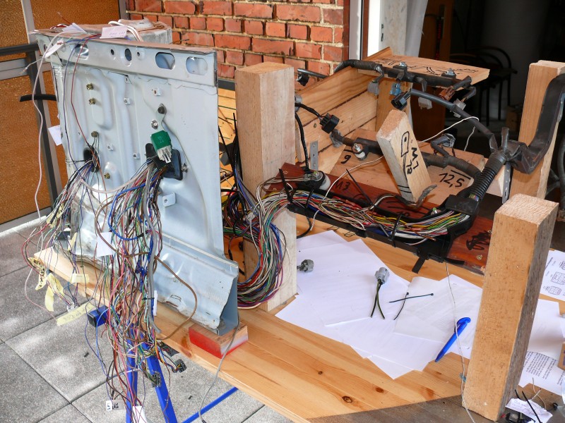

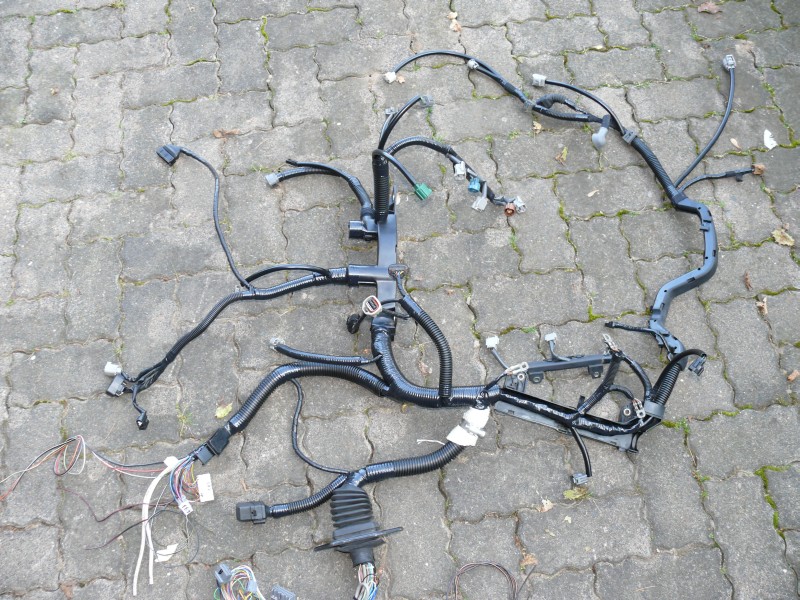

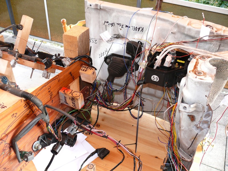

Now I can produce any V6 compatible wire harness:

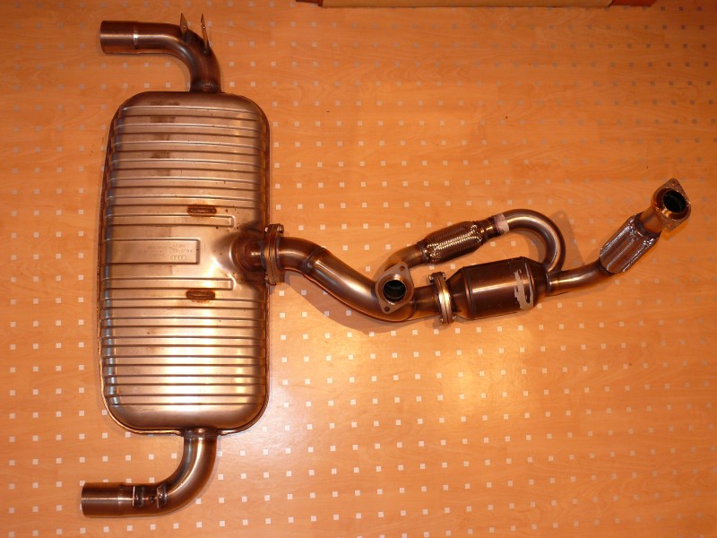

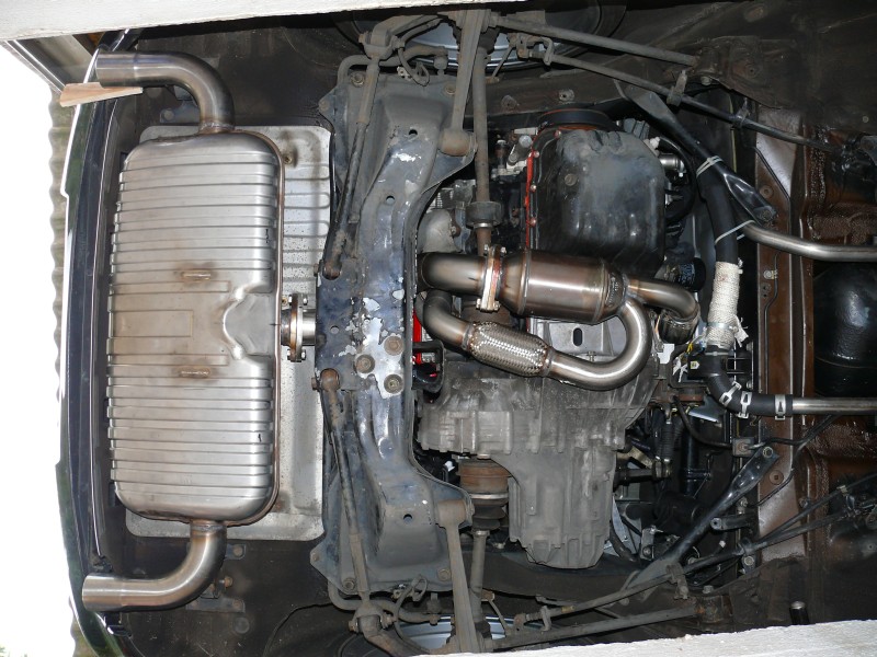

Now I work at least on a new exhaust system, I can make it compatible to the 3S-GE system or I use a original Audi TT exhaust, that fitt perfect under the MR2:

But there are so many specials, it is to difficult to explain. Most work is the wire harness, I need 40-50h to make it complete new.
